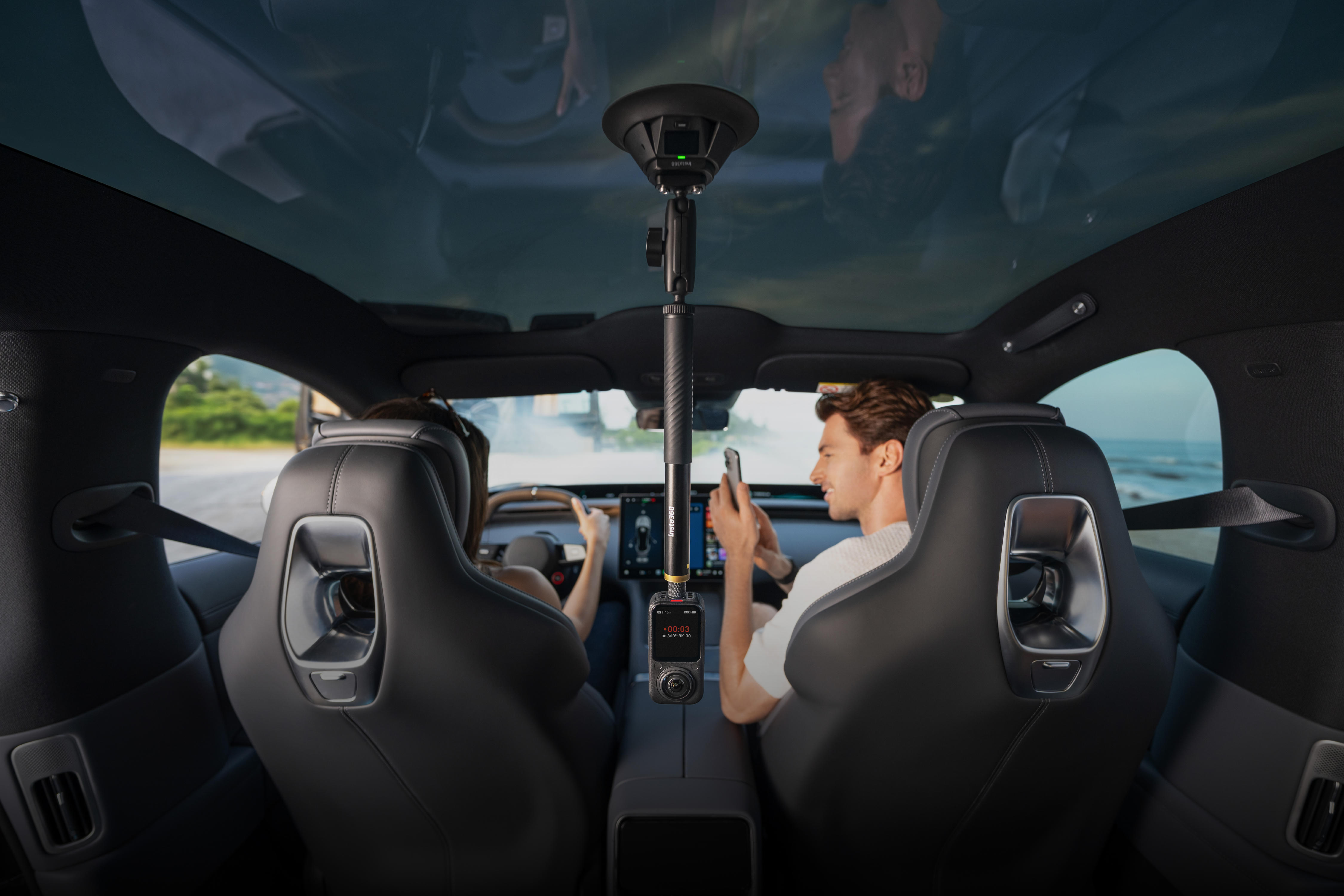

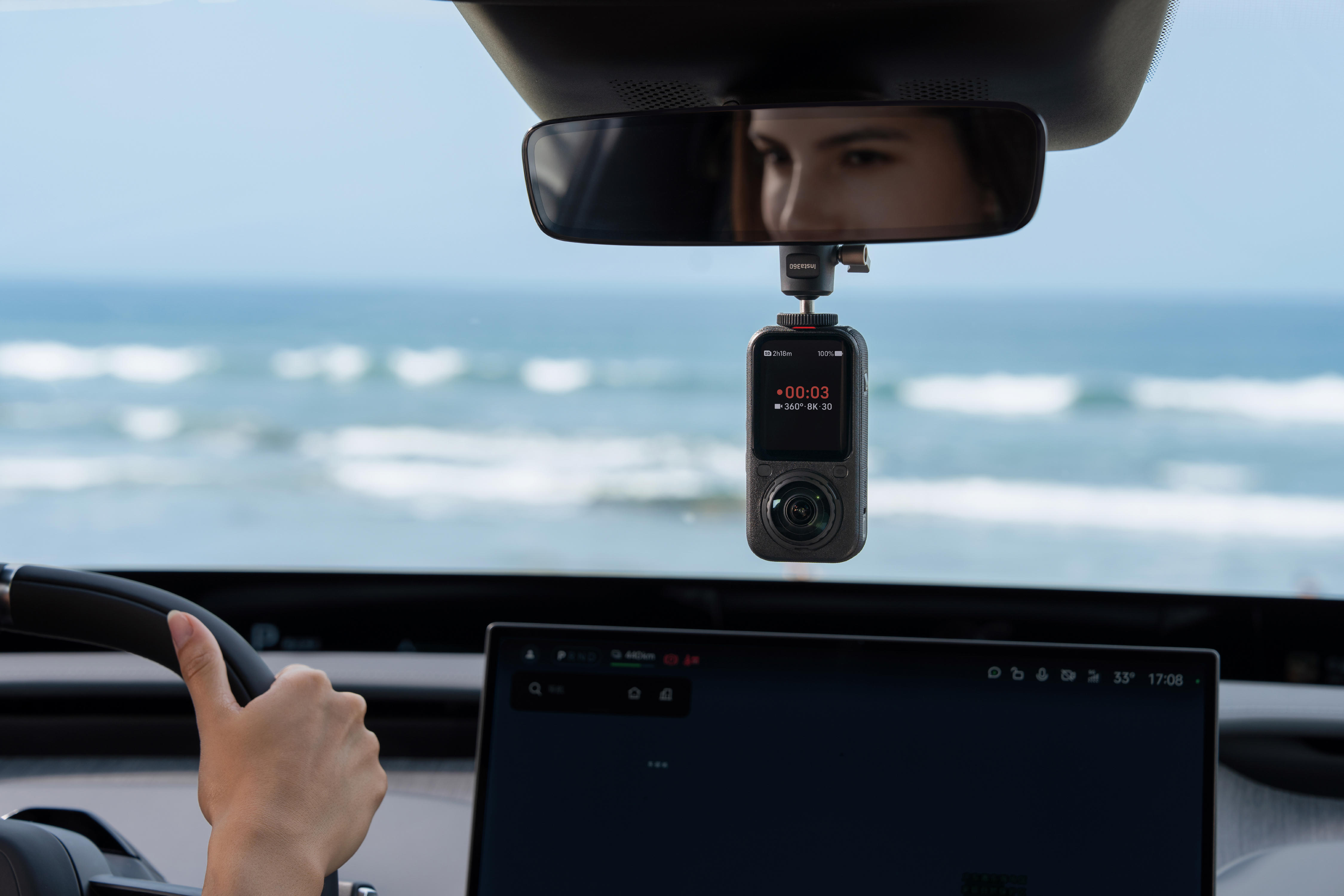

When mounting inside, setup takes minutes. A magnetic quick-release base clips onto a windshield or dashboard mount, and power runs over USB-C from a 12V socket. Installing the car mount is the only real step.

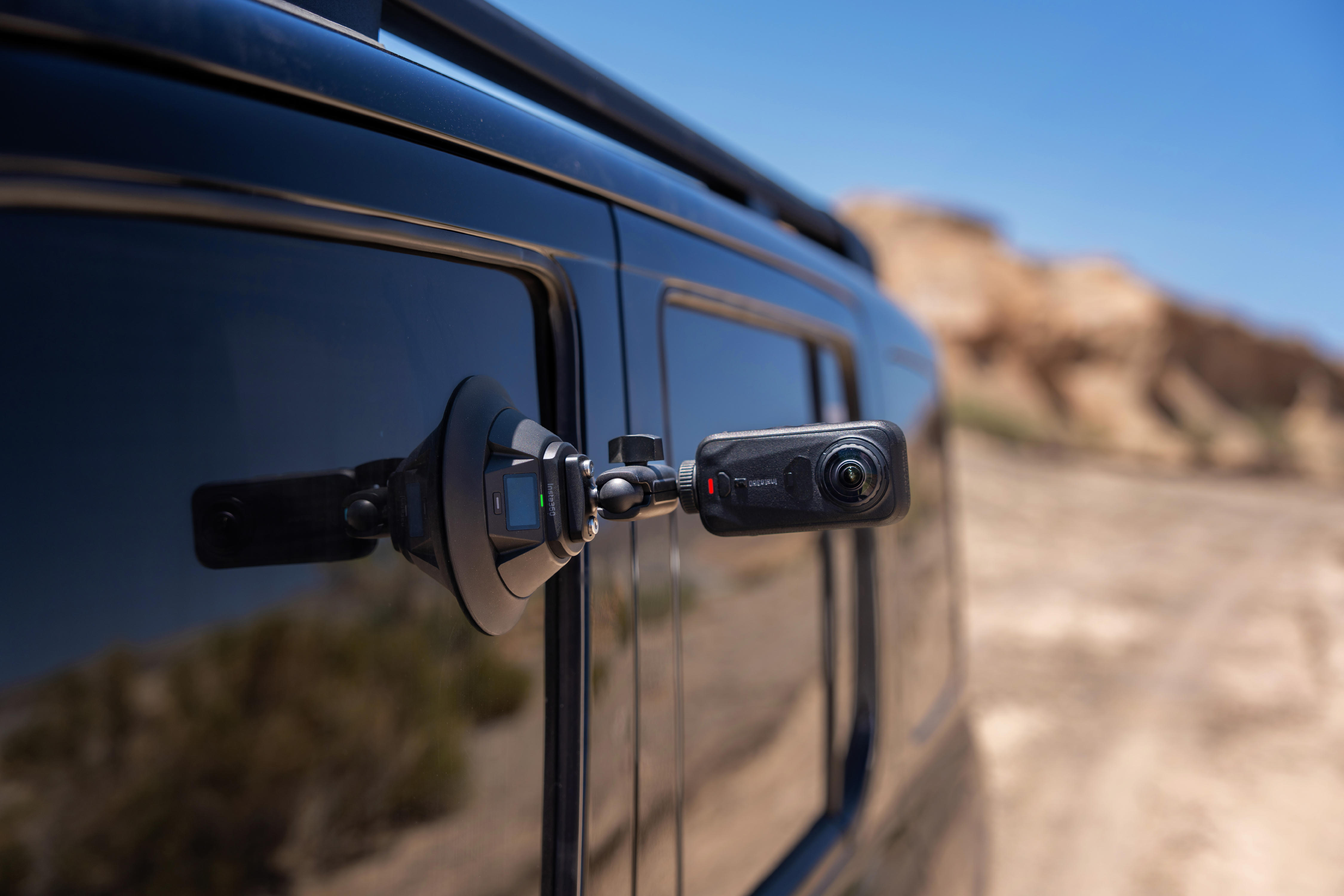

Mounting outside changes what you capture. A suction mount on the roof or hood puts the camera above the bodywork, picking up road surface, both flanks and the car behind in one file. Useful on a track day, on a mountain route you want to cut footage from or when a delivery driver needs to document damage around the whole vehicle.
Check the mount holds at speed before you rely on it, and check your state's rules too, since dash cam laws vary by state on mounting position and audio consent.

Insta360 X6 ships with 64GB of internal storage—47GB usable—with Road Mode already built in. Allocate the storage Road Mode asks for, plug in and it loops in 1-minute clips, overwriting the oldest once the space fills.
