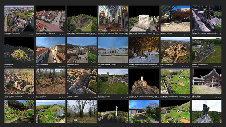

Visit SuperSplat to view more digital creations from Project Eternal.
