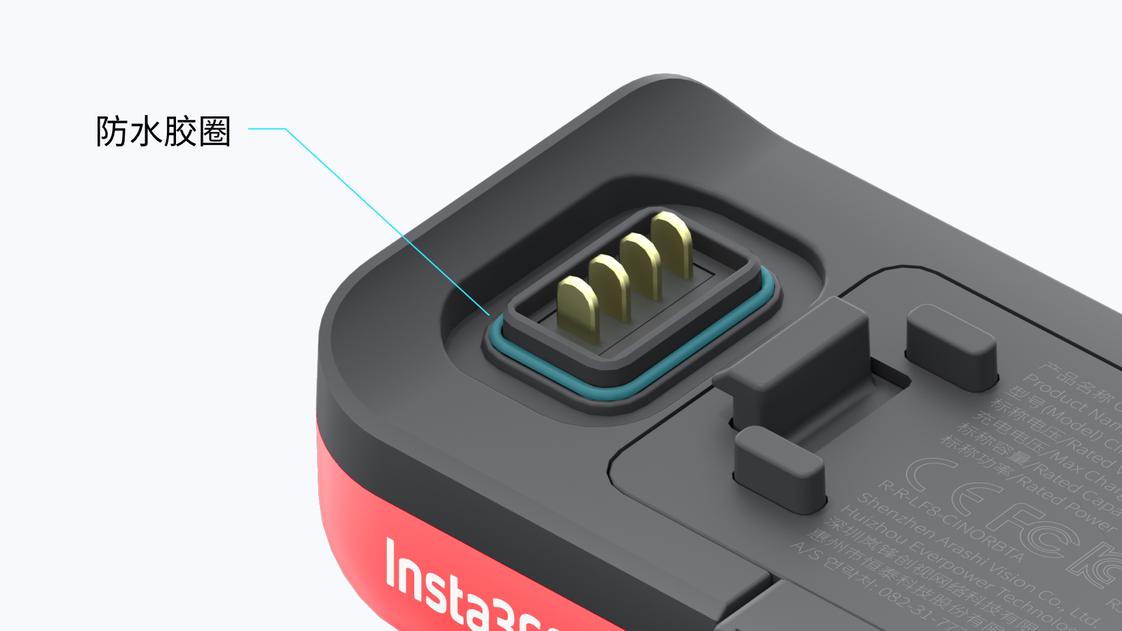

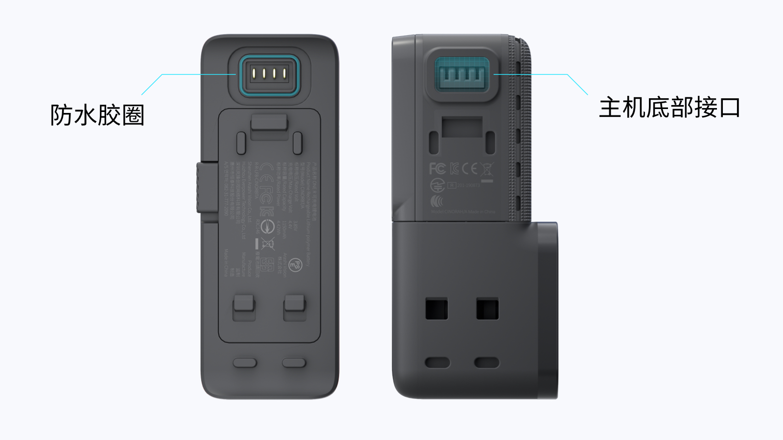

2. ONE R has gaps after assembly. Is it still waterproof?
Why does ONE R have gaps after assembly?
Slight gaps between the Battery Base and ONE R’s other components after assembly is normal. The gaps are the result of ONE R’s waterproof O-rings being squeezed into place and is a sign that they are firmly sealed together. ONE R achieves waterproofing through localized protection of key components, which becomes effective when they are joined together.
*ONE R is waterproof up to 5 meters when fully assembled and installed in the Mounting Bracket.
Why is the gap larger on one side than the other?
It is caused by the squeeze of the waterproof rubber ring shown in the picture. It's normal and does not affect waterproofing or camera performance.
