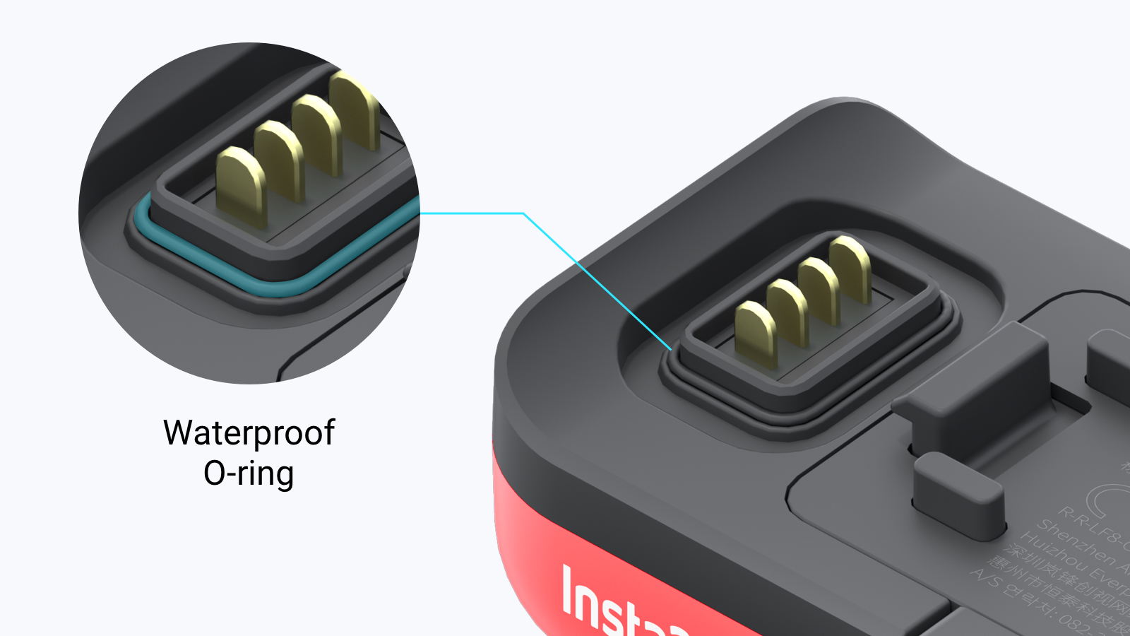

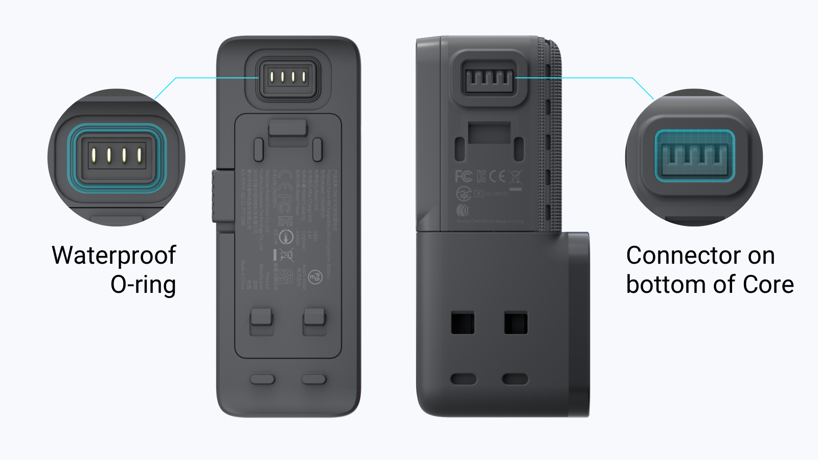

2. ONE R has gaps after assembly. Is it still waterproof?
Why does ONE R have gaps after assembly?
Slight gaps between the Battery Base and ONE R’s other components after assembly is normal. The gaps are the result of ONE R’s waterproof O-rings being squeezed into place and is a sign that they are firmly sealed together. ONE R achieves waterproofing through localized protection of key components, which becomes effective when they are joined together.
*ONE R is waterproof up to 5 meters when fully assembled and installed in the Mounting Bracket.
Why is the gap larger on one side than the other?
It is caused by the squeeze of the waterproof O-ring shown in the picture. It's normal and does not affect waterproofing or camera performance.
